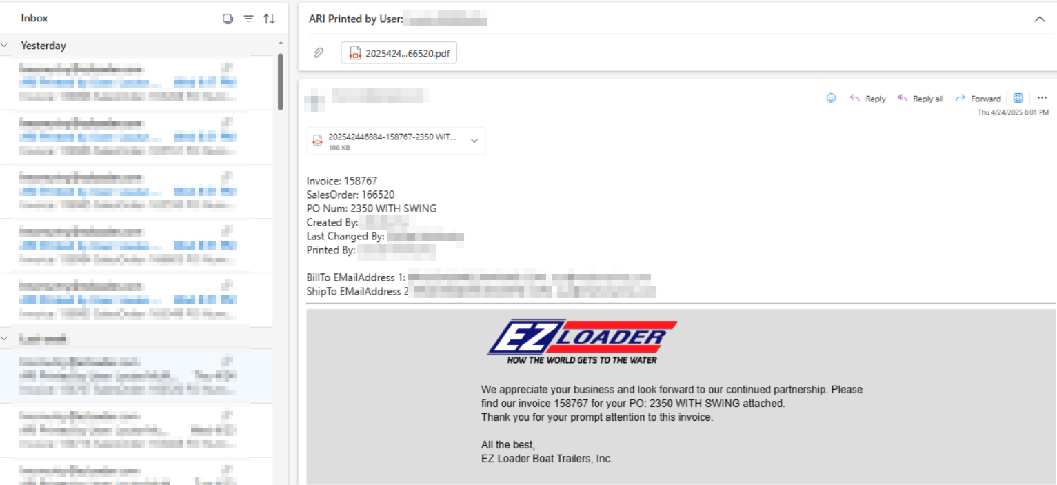

Ya, it is using a report style with an expanded dataset to include more info that the original report. It’s setup to store prints & sent emails in AR group’s shared mailbox. The lower half of the HTML email goes out to the customer emails along with the modified AR SSRS PDF. My point was you could create a full HTML style email using APR if you really wanted an updated look that would print prettily in landscape format right from email and/or the SSRS PDF to go with. You don’t actually have to send the PDF version of the invoice with the APR email. :slight_smile:

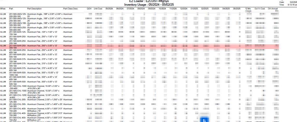

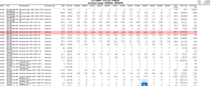

Here is sample look, but what Alisa said is so very true get good or contract someone who is :slight_smile:

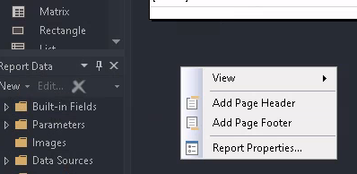

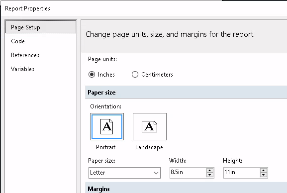

Okay, okay, to the point! The answer to this specific question: Right click on the background. Not the report’s body, the background in VS that it’s displayed on.
Select “report properties”.
