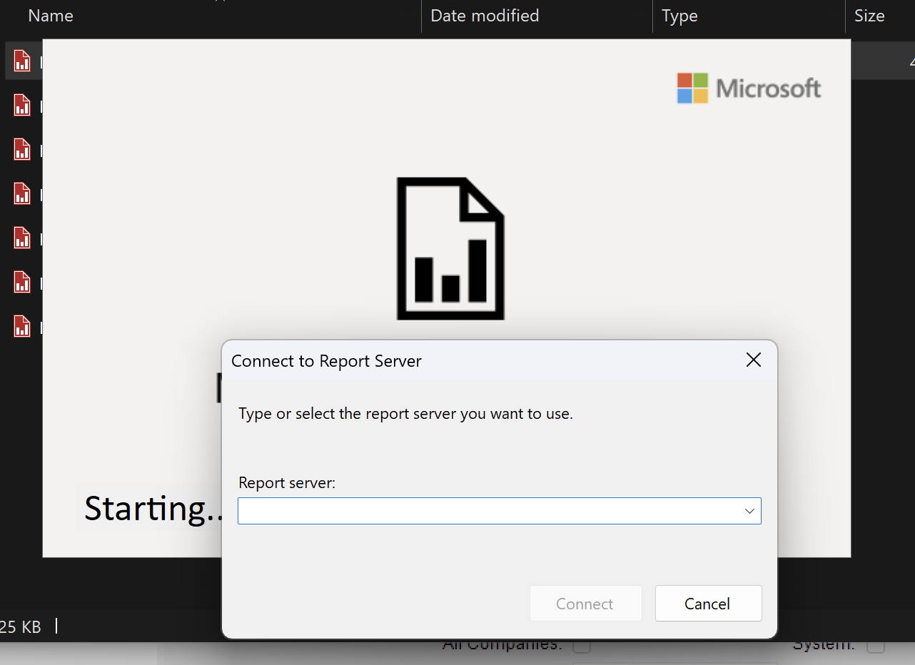

Trying to edit an SSRS. When opening Microsoft Report Builder it’s asking for a report server url.
Any idea where I can find that? Cloud, not on premise.

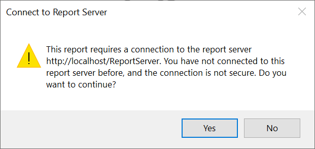

Can you bypass it, mine asks to connect to one, but not provide one.
I just click no.
I can click cancel, but I’d like to pull the data in. Trying to figure out an issue with the report, and in this case need the data to see the cause.
