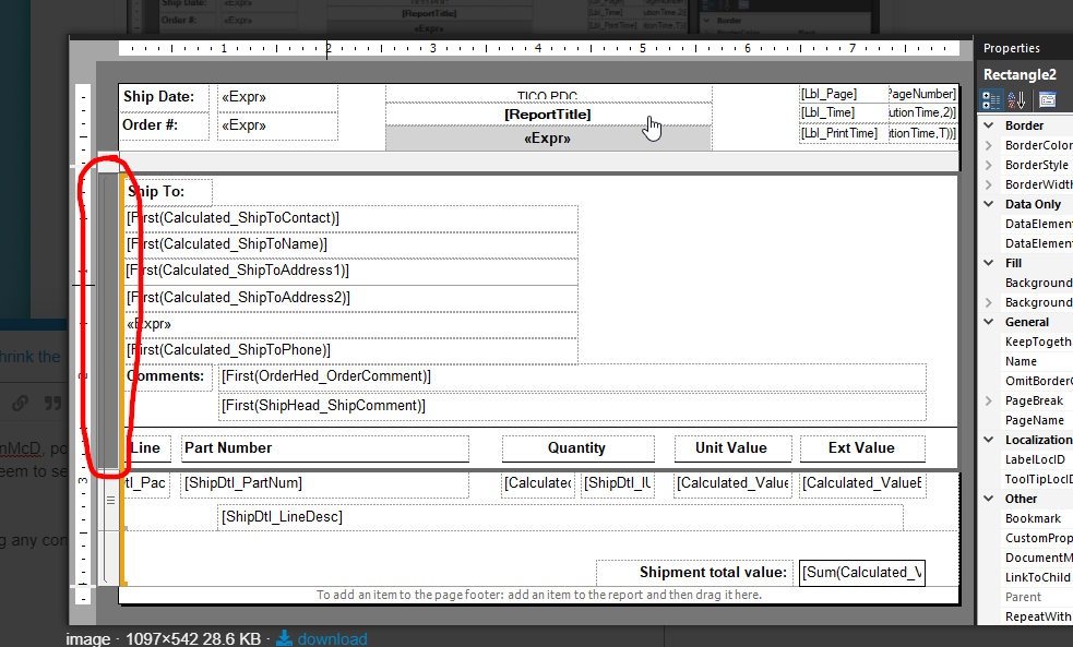

This is a custom pro-forma invoice, basically. The ship-to address fields are in a parent group-header of the data. Naturally, many fields are often blank, like Contact or Address2. I set them all to CanShrink. OK so far.
When I do this, the report crunches the address, but not the row (the group header), so all that space I saved just ends up under the column headers (and looks stupid).
Some Googling says click the row and set it to CanShrink also. But the row is filled with a Rectangle, of course, and I can never seem to select the row; it always selects Rectangle2 instead.

After selecting any control in the row, select the row “grip” to the left of the tablix

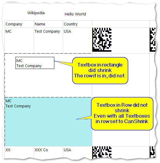

Here’s a quick test of a SSRS report with various nested controls and settings.
And the result:
