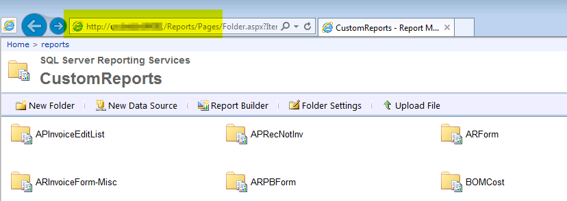

The RDL need to be in the SQL server, not on a local machine.
I highlighted in, because it needs to reside in the DB. The report location field for Report Types of SQL Server Reporting, is not a path to a file location, but rather a “path” to the RDL definition stored in the DB.
Open IE and enter the address shown below (substituting your SQL server for the obfuscated part)
Here it is in text
http://<your SQL_SERVER_NAME>/Reports/Pages/Folder.aspx?ItemPath=%2freports%2fCustomReports&ViewMode=List
