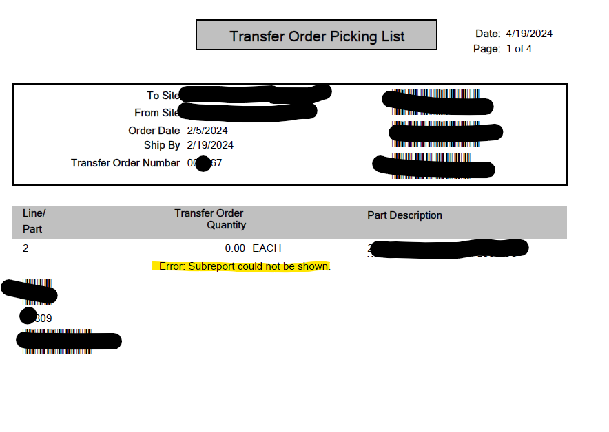

I’m creating a custom report from the Standard TO Pick List, and trying to add a subreport to it. I get the error, SSRS report: “Error: Subreport could not be shown”

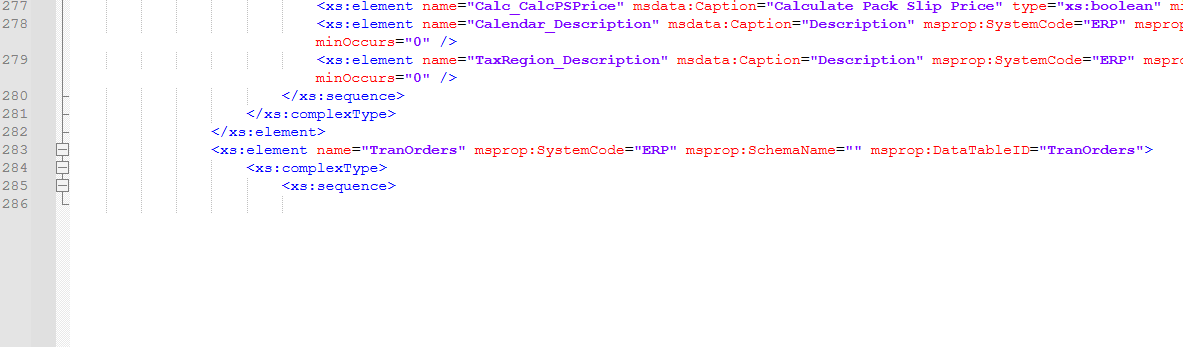

When using the output format as XML, this is where the XML ends (Epicor support pulled this out.) Not sure if it’s relevant, but trying to put all the information up front.

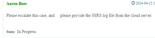

It wasn’t Tier 1 support, but I’ll check again. And yes, I believe you that it would be helpful. I started the request asking for access / a download of the SSRS log about 3 times. I’ll try asking again, but he doesn’t seem to be to willing to be flexible. = )

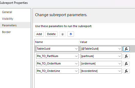

As for the subreport, here is the call to the subreport:

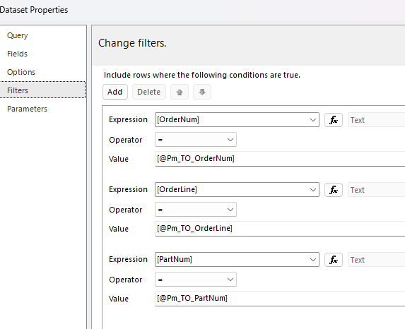

In the subreport, the later three parameters are used as filters on the dataset:
This seems to match how the SO report is set up.
I have not done a sub-report in a while. Is there something you need to set on the main report for the sub-report. I want to say it is something like passing the GUID from the parent to the child. I can’t remember, look in the Properties of the sub-report in the main report.
The ticket has to go to the Cloud team I believe. Not sure if that is who it is with :man_shrugging:
That’s the first screenshot from my last post, that’s done – “Subreport Properties”.

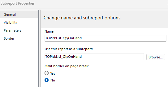

Make sure that in the name for the subreport you ONLY use the name and not the full path to anything.

For future reference for anyone, this is what it should look like when pointing to a subreport, and Epicor support did tell me that if you can upload and download your files without issue, it’s probably not an issue with how the subreport is set up.
