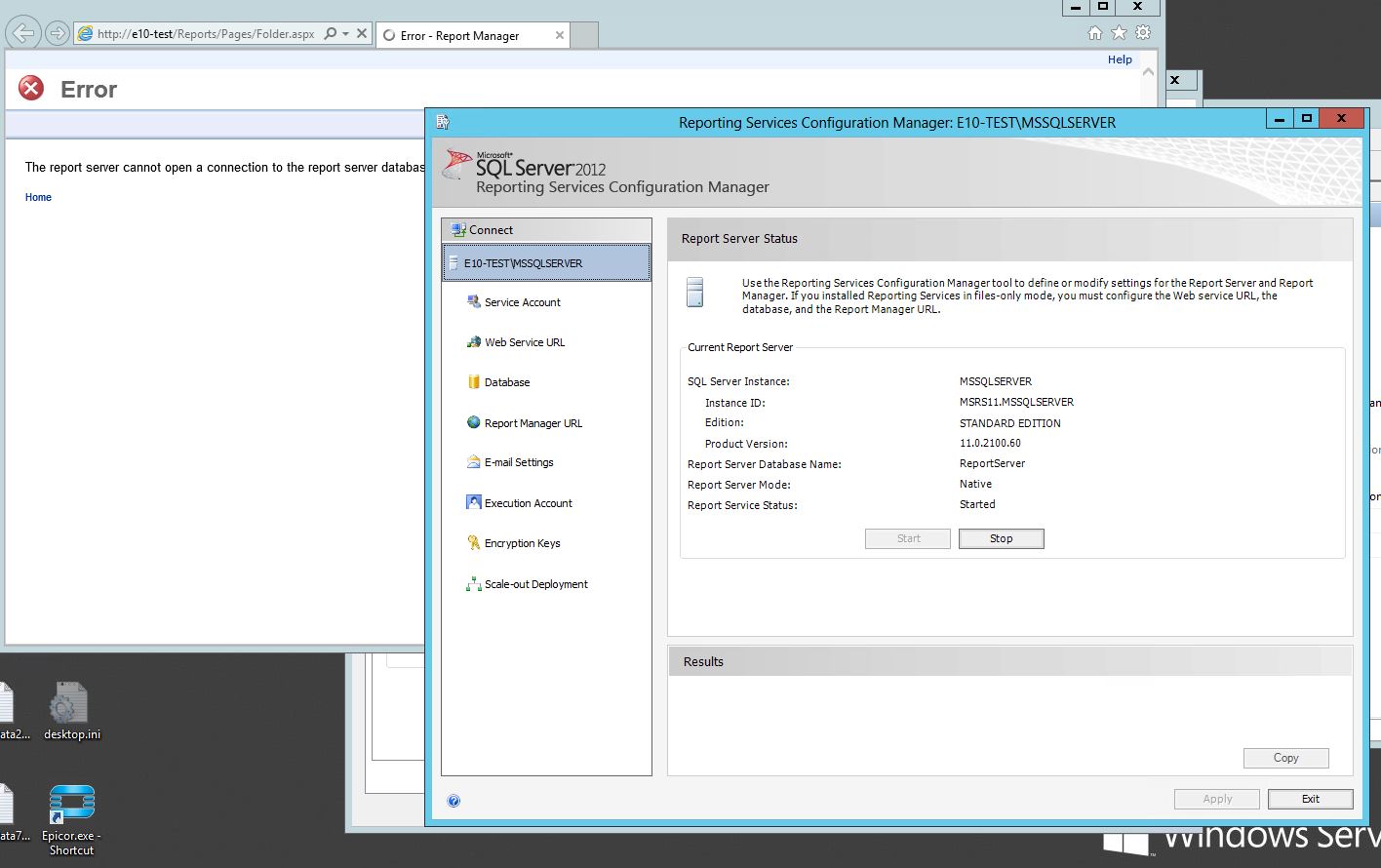

Neither SSRS Report Services Configuration.
Goctcha, got it up. What are we looking for?
Is ti configured? is it running? is it giving you any errors?
It is configured, running and no errors.
But you said you can’t browse to http:///Reports
You should run through the change database process and create a new one
http://jcg.pictures/gdgfaiedYNxX.png
So I did that and then I went to the Report Manager URL. Clicked that and got the same error, The report server installation is not initialized.
Did you also Re-Gen your encryption keys?
No, that I did not. :pensive:
So, I had to delete the encryption key and now i can access the URL. However, Epicor is still giving the same error.
now you go need to g to Epicor and Re-Deploy your SSRS Settings so that all the Reports gets imported. Make sure your user and the Epicor user account running the Epicor Service have access to writing / reading to SSRS and Report Designer etc.
Yeah, I went with rebuilding by accident and got stopped on WCF Http activation. Crazy.
