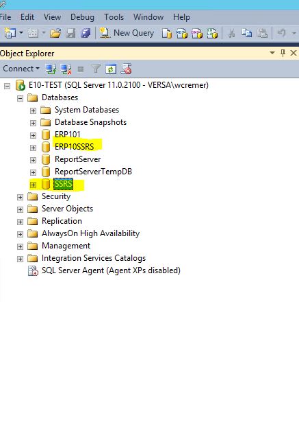

Ok, Newb question: How do you transfer the SSRS over to a new database? I have created a VM with a new SQL instance completely separate from my live. I have all the Epicor info transferred via backup and restore. Tried that with SSRS and got nothing. Every report I run gives an error because it can’t find the SSRS report.
Ok, well I noticed that when I restored the SSRS to the new Epicor, it recreated the original database, name and all. It didn’t just copy the info into the correct database that was already there. So, what did I do wrong, and I how do I fix?

I think I know the problem here. Before I posted to this site for suggestions and help on how to bring the data over from my live environment, I did a backup on the Epicor db and the SSRS db. Then I recovered the Epicor db and that went great. Next I recovered the SSRS and instead of putting the info where I wanted it, it made a whole different DB called ERP10SSRS that has all the info. So I was thinking connect to that one as it has the info in it. That is when I started getting this error. So, unless there is a way to initialize that db, then i will have to go a different way to do this.
I really don’t think you need to do much here. Open SSRS Configuration tool and re-initialize a database, generate new keys etc. The Epicor SSRS DB is just a DB full of “jumk” ( as in data for the reports) that one never needs to be backed up restored or moved around.
