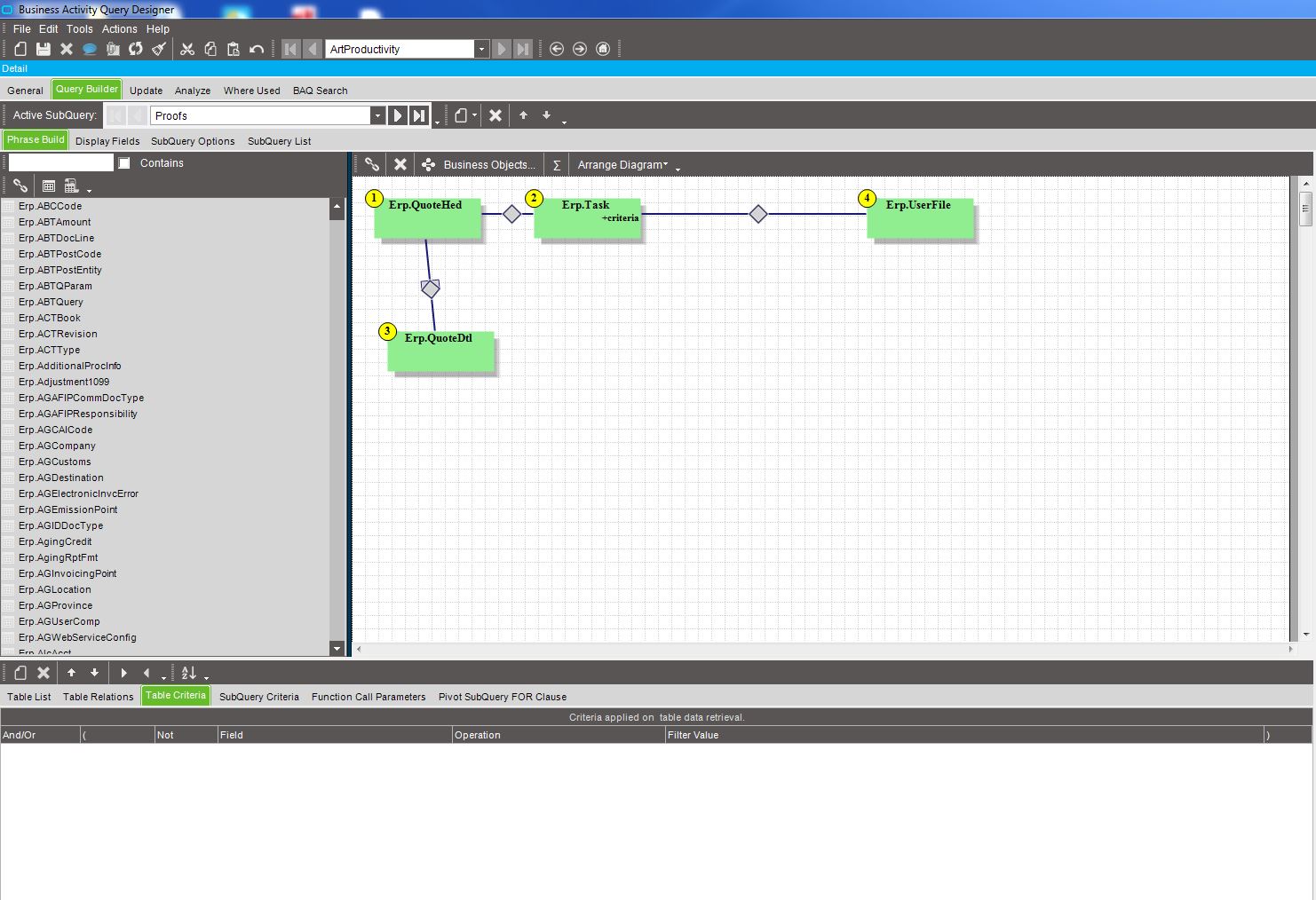

To help understand a little bit more, we have artists we we like t keep track of the Proofs they do for customers and Steps the do. So the Union is between Proofs and Steps. So my next queston would be, how woudl I get this data to show up for me all on the top level if it is Union? Or do I need to rewrite it so it is not union?
The top level has all of the data. Put another field in both that’s just a calculated character field. In the Steps one, make the value ‘steps’ and in the proof one make the value ‘proofs’.
Then when you run the query you can see which table it came from.
Put another way, how many rows do you get when you run just steps? How many when you run just proofs? Does the union number of rows equal both of them put together?
It’s like taking 2 decks of cards and then shuffling them together. If they look similar, it’s just a bigger deck.

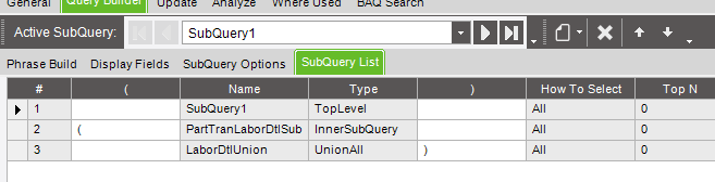

Put the first InnerSubQuery on the TopLevel and it will pair itself with the UnionAll SubQuery.

@hkeric.wci @Banderson Her is the BAQ I am working with. May not make much sense for your company, but figured and extra set of eyes would help me out. I really need to figure out a way to get these to pull in the same report.
ArtProductivity.baq (36.7 KB)
I have done UNIONALL for the Subquery and the data pulls into the BAQ testing. However, when going into the SSRS, it just shows the top level BAQResults.
There is only one level William. When you do a union, you take two tables/queries and combine them into one table. Does your top level have results from ‘steps’ and ‘proofs’? I see you have the calculated field in there to see which one it is.
It shows up in the BAQ when I test it, but not when it goes to SSRS. So, if IA m understanding correctly, SSRS will only pull the info on the top level, even if the BAQ will pull in from both top and bottom because of the union?
