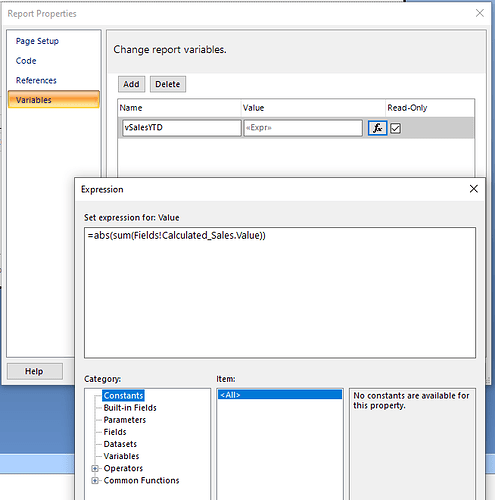

I attempted to declare/name the variable in Report Properties | Variables - I don’t understand this area - I’m missing something simple but I have no clue what.
Here is my attempt: (I have tried several different flavors of this too with no success)
This pops an error when I try to run the report:
The Variable(vSalesYTD) expression for the report ‘body’ uses an aggregate expression without a scope. A scope is required for all aggregates used outside of a data region unless the report contains exactly one dataset.

** I found a solution but I’m still looking for resources on formatting…
I needed to use the dataset name :woman_facepalming:
=abs(sum(Fields!Calculated_Sales.value, “BAQReportResult”))
