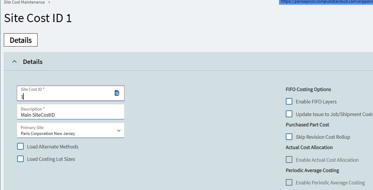

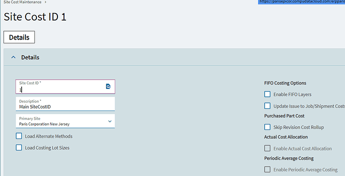

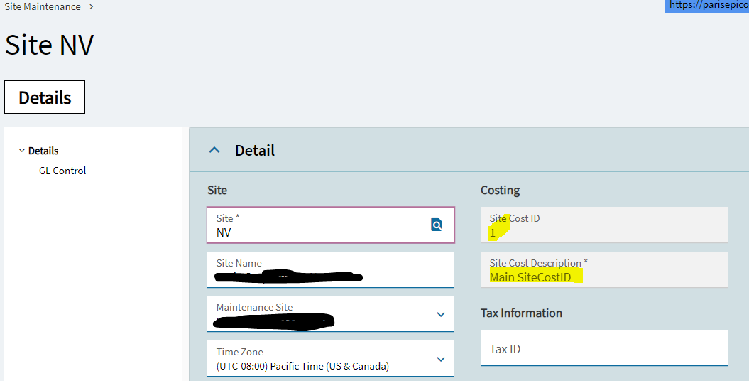

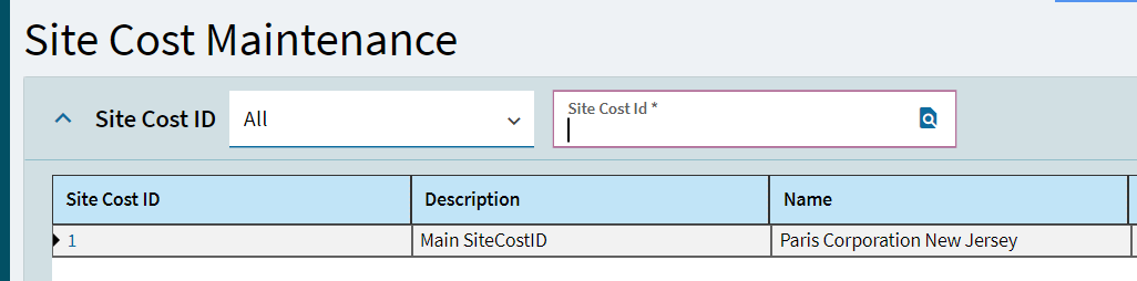

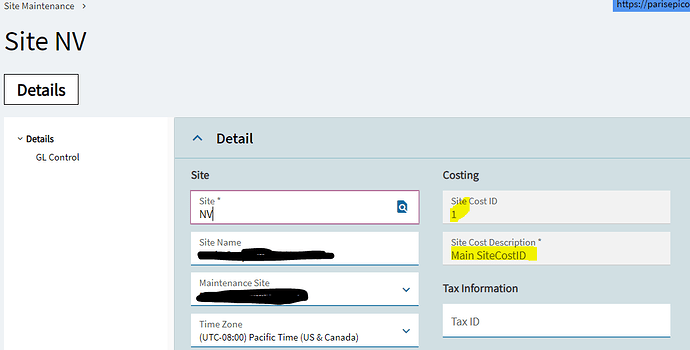

Correct - look for Site Cost Maintenance to set up the “versions” and then enter them where appropriate in Site Maintenance. Some screnshots below…we’re multisite but only use a single cost ID. All manufacturing is done at our HQ. We stock our outside sites via transfer order…or via regular PO if it’s made/delivered by someone else.
