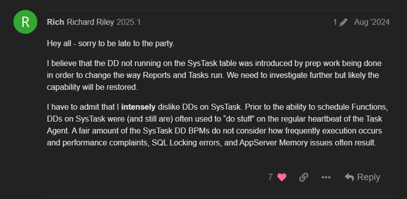

That seems right according to Rich:
Not sure what the remedy will be though…
Yes, he was talking about Data Directives. Seems like Method Directives that are tied to systasks do not fire either (in cloud)
