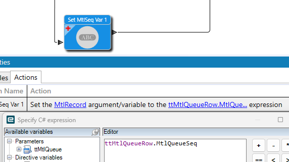

In your SetMtlSeq Var 1, you are trying to set it to the value of 1 row, when there are more than
one. You either need to process for all rows, or pick a row to get your value from.
@klincecum I would need to process for all rows… not too sure how i would go about that?

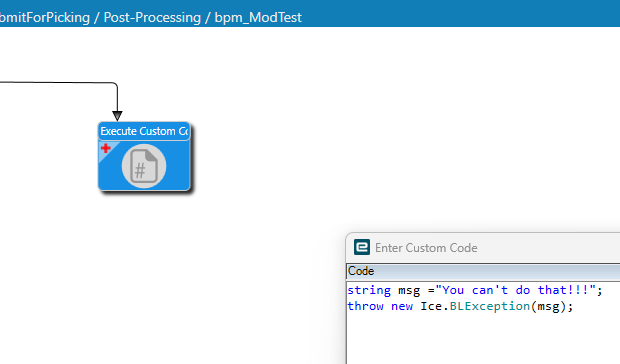

I have tried running this through MaterialQueue.Update Post Processing but it doesnt run.
What does that mean ?
Have you done a trace and seen exactly what is called normally?
It may not be Update.
I ran a trace but it returns no Methods.
I am trying to hook onto a process that was created by a third party consultant.
the In Transaction directive on the MtlQueue table is the only directive that seems triggers anything.
I have resorted to using the below to figure out which methods or tables i can use in Post but nothing happens.

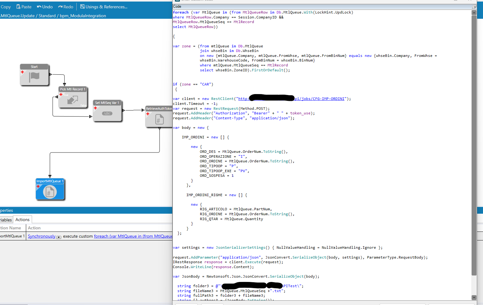

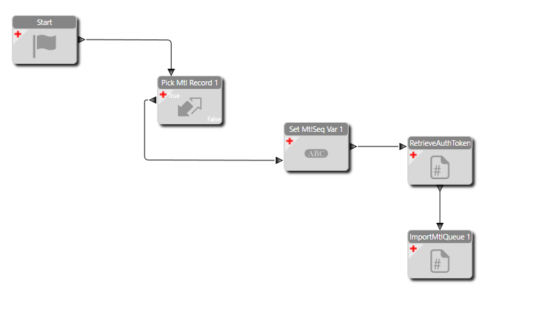

@klincecum I have managed to get the Standard Directive firing and bringing over the MtlQueueSeq field from in transaction. which is a great start so thank you for pointing me in that direction.
First issue. if i update 4 records i only get the latest record not the preceding 3.
Second issue, The post to the API fails but i imagine it is to do with the below error from Event Viewer.

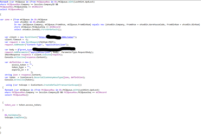

I can create .txt files for each record updated which contains the correct data from within Standard Directives using.
I cant however trigger the API post code block after this using the code.
