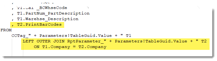

Bruce - this was exactly what I needed.
I added in the left outer join to the “RptParameter” table and was able to pull in the “PrintBarCodes” field, like so:
Then, I simply referenced that field to [in my particular case] show, or hide Excel columns that contained barcodes, based on that report parameter selection.

Pretty slick.
Thanks again, Bruce. Perfect solution to my problem!
