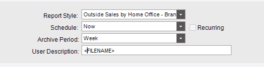

for some reason i seem to remember there is a small set of parameters / keywords which are available to use in the standard report user description. these provide some functionality like setting a filename or replacing the user name in the system monitor.
eg or
i cant find any mention of it in any doc.
does this sound familiar to anyone??
TIA

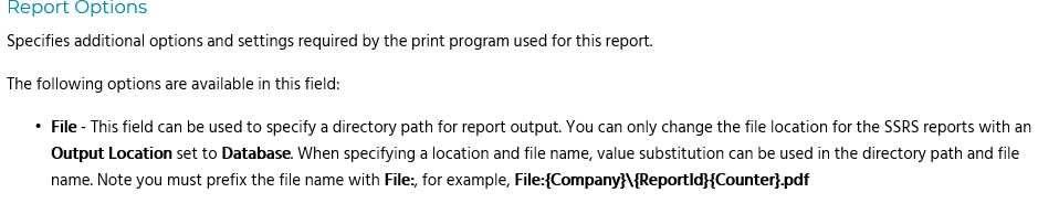

I think that will work, but it is at the Report Style Level. Every report run using that style would use those options.
And I’ve thought about do the same thing. But we have APR, so it was just an exercise that I bailed on.
The help Topic on Report Style-> Details -> Fields, has the following table for paramaters to be used for Bartender or EDI report location. Maybe some work in the Report Options too.
Unfortunately none of them are dependent on the report’s data.
