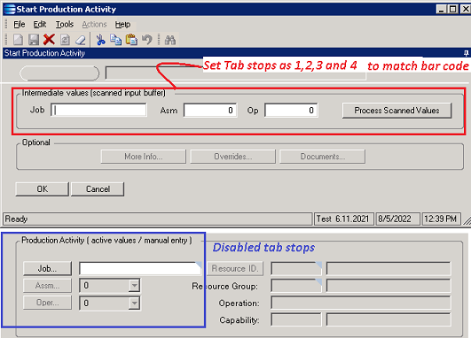

TBD if helpful but… if I remember the coding wasn’t too hard. most of the “fiddling” was spent in getting the tab order on the form to match the custom bar code on the job traveler. If you search this site I think you’ll find several good examples of concatenating bar codes.

'//// i.e. scanning the bar code should populate the 3 intermediate UD fields
'//// Temp - manual processing button click
'////// Copy UD values to "normal" Start Activity fields
'///// Pending - add auto processing (scan only - no manual clicking )

I created an EpiTextBox and a button to process the barcode input (update data views). I edited the Job Traveler SSRS report to include Job Number-Assembly-Operation on the barcode (being split by a dash “-“ and no spaces), I also have enabled Full ASCII mode on my barcode scanner so I can put a tab and enter ("$I" + “$M”) at the end of the barcode so it automatically presses the process button after filling out the EpiTextBox with the correct information.
