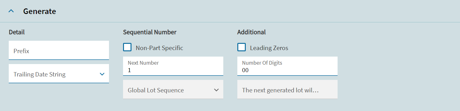

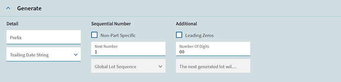

Yes, you can create a Global Lot Sequence with ‘Global Lot Sequence Maintenance.’ But you will have to define each Part Site’s Lot Sequence to follow the Global Lot Sequence, if you haven’t already.
After you setup the Global Lot Sequence, then each Part Site has to be set as Non Part Specific and you pick which Global Lot Sequence to use.
Be aware of each parts Prefix & Trailing Date settings, if either are set those will bookend your Global Lot Sequence: [PREFIX][LOTSEQ][DATE]
