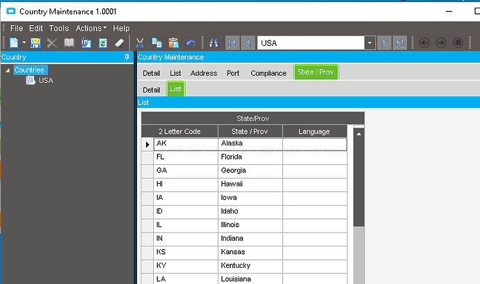

We added a UD table as a child to the country table. Just found it a little easier to maintain this way. But User Codes work just as well.
Thank you both for the suggestions.
I think we’ll try the child-to-the-country-table idea, as we ship to many countries. I’ll report back on the experience in June, when this request makes it to the top of my pile.
