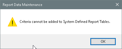

My prior suggestion of adding criteria to a custom RDD won’t work, as you get:
So you’ll have to exclude that Part Class from the SSR, by either of the following:

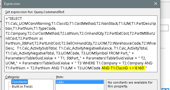

Make a new Report Style and RDL, and modify the RDL to exclude Shop Supplies. You can do this right in the Query Expression, like:
(where6160is the ClassID I wanted to exclude)

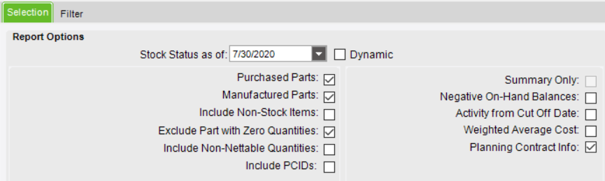

One other avenue to investigate would be to set the bins that these parts are in, to “Non-Nettable”, then uncheck that box on the Stock Status Report form.
