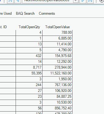

This is a strange thing I have never come across before. In a BAQ, I am looking at the Order and Job tables, and summing the open value of sales order releases, rolled up by job number. Only one value in this data is throwing me off. Take a look at this screen recording. You can see I am stepping through the BAQ grid looking at each value. When I click on the value over 11million, the 11million disappears and I am left with just the 522k that I expect. I have no idea where the extra 11 million came from. It is not in the underlying data at all. As you can see, the value changes depending on whether I am in the field or not. I don’t even know where to start with this!

Notably, I am filtering the releases for req dates in a given range. I am also excluding a handful of specific customers.
Does anything here stand out to you? Why is the BAQ field showing one value but holding another? What’s going on with that?
baq1
i’d say some format error. Do you set format in the calc field? Change it for something longer
The format that was automatically assigned is:
->>,>>9.99
This works for all the other values. As far as I can tell nothing shows an extra 11 million on top of the true value. What should this format syntax be to accommodate 6 or 7 digit currency values?
try something like ->,>>>,>>>,>>>,>>>,>>>,>>9.99
This sort of works, in that it now shows the 11 million, but it doesn’t change when I click in it. The value should be 522k, not 11mil. If I open the grouping, I can see there is only one value being totaled in the sum. I have no idea how it is getting up to 11 mil. The entire list of values only totals a little over 1 mil.
EDIT: ohh Im wrong! The underlying value should be about 886k, not 522k.
yes, UI changes were because of too short format. It of course did not change the query result, it is just presentation problem.
Ahhh I found it! My sum calculation is basically multiplying the value I want by the number of releases. I think I can fix this.
Thanks Olga! That format thing really threw me off!
