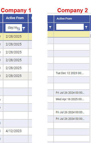

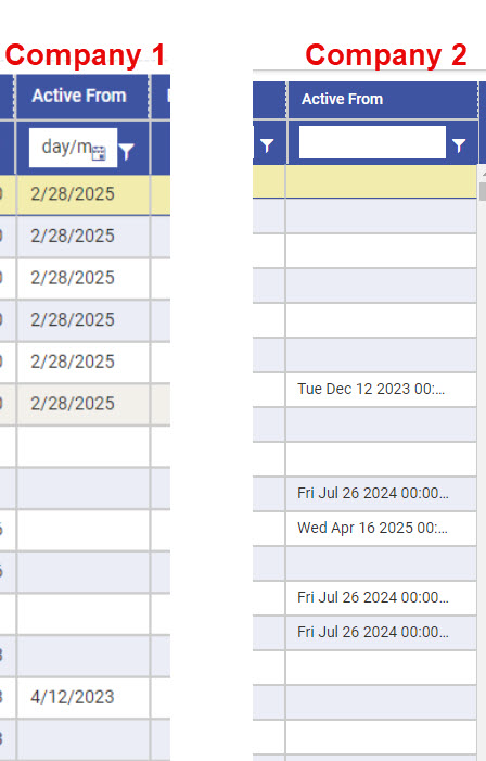

i have a 2 home pages set up exactly the same on 2 different companies. They have the exact same BAQ(A shared BAQ) on and all the same fields shown, but the date field displays differently. any ideas?

I don’t have multiple companies to test this with, but check you Company Configuration > Localization options for both companies. That is an odd one!
Are they both in the same country? Otherwise I agree with @NateS it could be a Localization issue.
Cheers but no differences i can see in there
Both in the same country

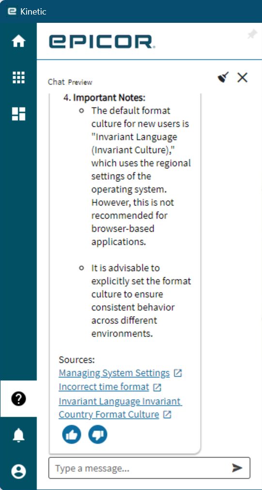

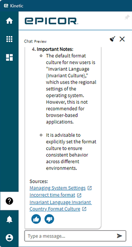

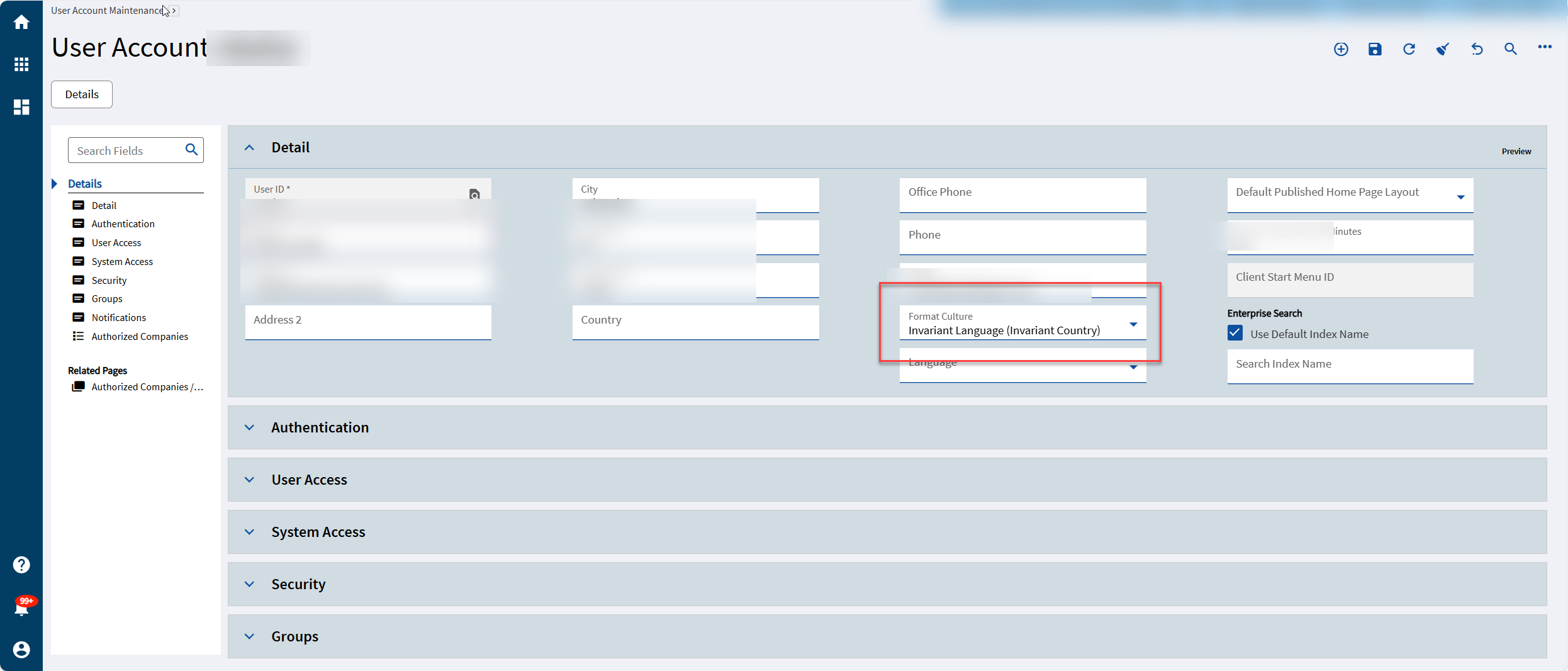

I found there is a way to set it per user as well:
Also found this at the end of asking help’s chat feature:
Randy, still nothing im afriad. its baffeling me

We had this issue a while back too. Support also told us to apply the correct format in User Security Maintenance and then also ensure the correct settings were set in Windows Region settings.
None of this helped until it was fixed in a later release.
