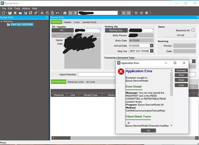

Still using the classic version of Receipt entry. One user noted a strange error we have never seen before. “You can only specify the READPAST lock in the READ COMMITTED or REPEATABLE READ isolation levels.” Image and text below. This happened after he performed these steps.
  1. Create a new receipt entry, enter PO and Packing slip.
  2. Correct the arrival date, press tab
  3. Error pops
    This is not repeatable, only some are generating this error. We ignore it by clicking the X, and the rest of the receipt entry goes fine.

Application Error
## Error Detail ##
##!Message:##! You can only specify the READPAST lock in the READ COMMITTED or REPEATABLE READ isolation levels.
##!Program:##! Epicor.ServiceModel.dll
##!Method:##! CallWithCommunicationFailureRetry

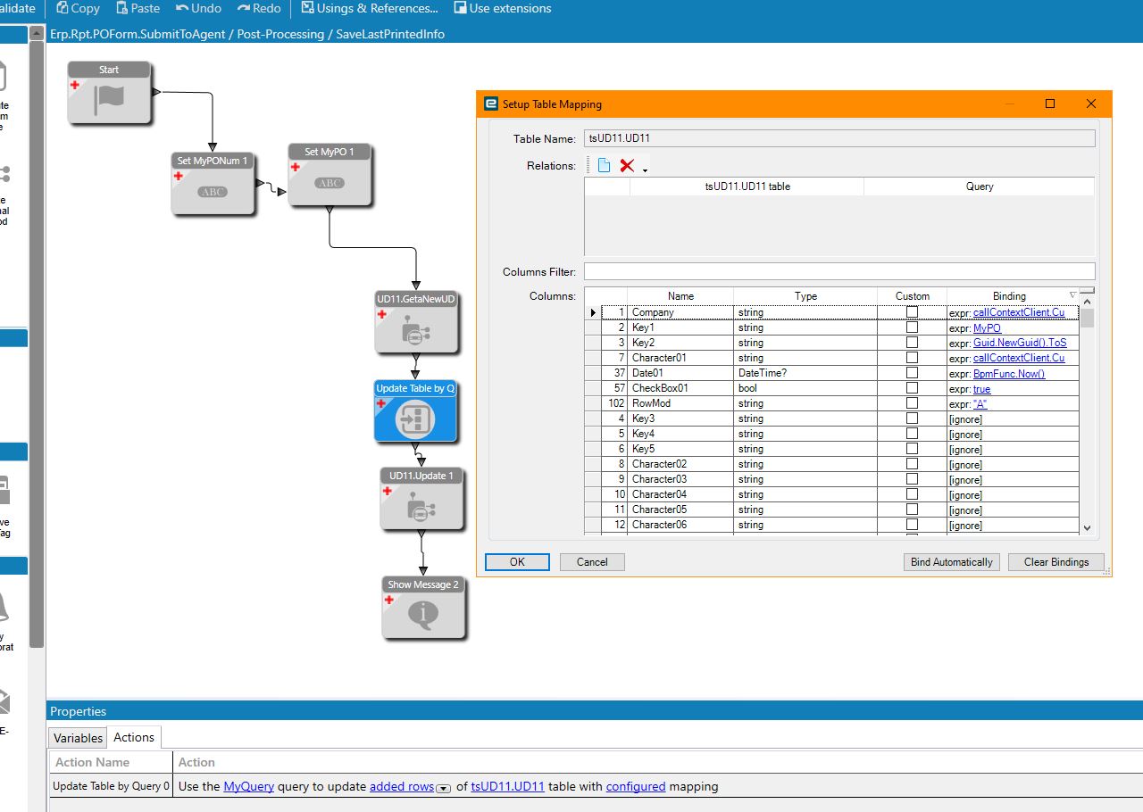

Do you have any BPMs tied to Receipt Entry?
Nothing on receipt entry, but on POForm, I have this Post proc method directive:
This just saves a line in UD11 to show that the PO has been printed. This is used elsewhere, and still seems to work fine.
Also confirmed no customizations on Receipt Entry. :thinking:
So… no BPMs that would be locking rows…
