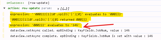

Hannah, I tried your evals and they worked perfectly, but I did the same with the #_ _# and also worked, with a tiny caveat for the string element.
I had to parse this: ‘000222|1|10’ (string|int|int)
The evals worked perfectly.
eval(“var text = ‘{TransView.something}’; const myArr = text.split(‘|’); myArr[0];”)
eval(“var text = ‘{TransView.something}’; const myArr = text.split(‘|’); myArr[1];”)
eval(“var text = ‘{TransView.something}’; const myArr = text.split(‘|’); myArr[2];”)
Then I tried the #_ _#
#‘{TransView.something}’.split(‘|’)[0]# doesn’t work
#‘{TransView.something}’.split(‘|’)[1]# works
#‘{TransView.something}’.split(‘|’)[2]# works
For the string element [0], it seems to be treated as a “number”, still 000222 is evaluated to 146 therefore an error.
So I tried adding a .toString()
#‘{TransView.something}’.split(‘|’)[0].toString()#
Same thing, error because evaluated to 146.
The solution was just to surround the expression between single quotes
#_ _# ':
‘#‘{TransView.something}’.split(‘|’)[0]#’ works
