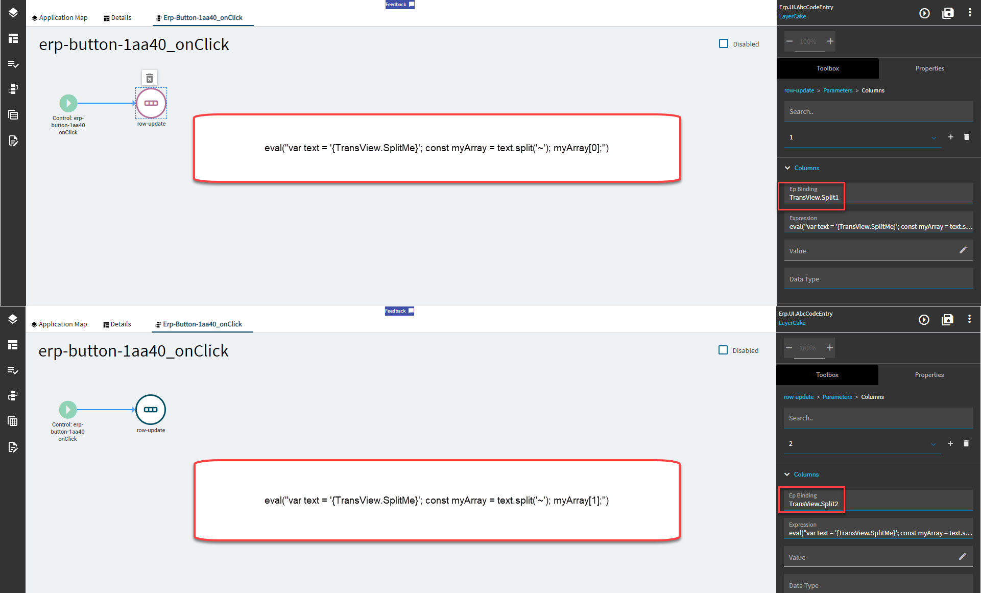

Sorry, turns out eval() is the one to use in this scenario.
JavascriptEval

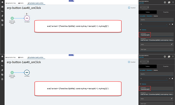

Looks like js but you are not using #_ your code here _#. So how we should know which syntax, which language to use and where (within which widget and which field)?

eval() processes the statements within and returns a string. The #_ _# I think just executes Javascript. For some reason #_ _# wasn’t working so I tried eval() and it worked, so do with that what you will. It’s all a bunch of black magic and guesswork anyways.
It’s always going to be some form of Javascript within AS.
