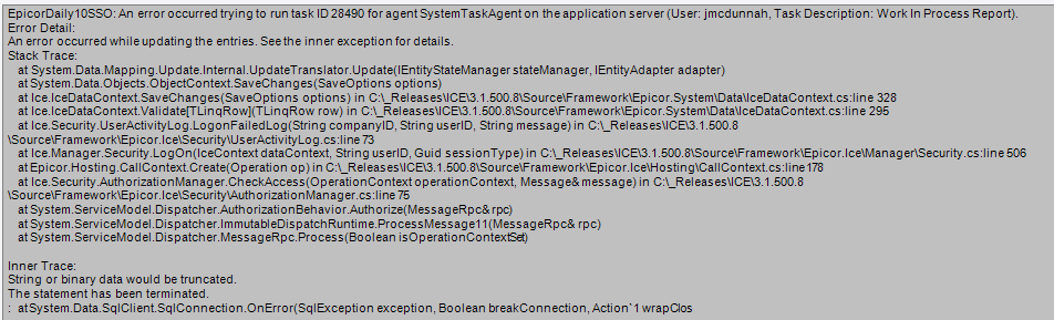

In one of our testing environment we have begun encountering frequent instances of the error message shown below. These appear for various reports/tasks and for various users. Some users see it with every attempt to run a report.
The stack trace consistently includes reference to UserActivityLog
We have restarted all instances, task agents and servers but the issue persists.Some users are fine, but others are not.
Is there any know issue related to the Activity log that might be the source of this error?

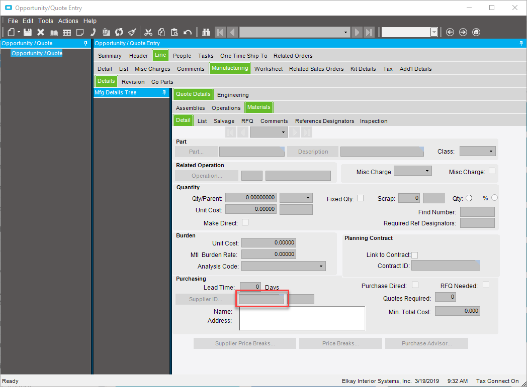

E.g. this came up for a user when trying to copy a templated quote line to a different quote line during the “Get Details” operation. I systematically removed materials and operations, trying the “Get Details” after each removal until it worked. Once I found the offending line, I started systematically updating fields and doing a “Get Details” until I could find the offending field.

Umm, I believe it was the Supplier ID, but it’s been awhile.
