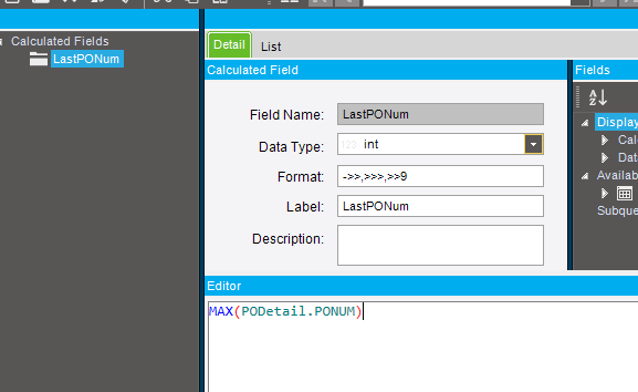

Lowest Level Subquery:
Group by fields checked on this screen (calc field not checked)
Results (when switch to Top level query from inner subquery, switch back after)
You start with the PODtl, since that table holds the PartNum (which you need to group by so you can link it to its respective PO). I included the Company column for faster join time later on in the query.

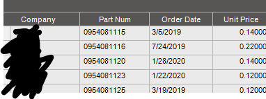

This will eventually be your second inner sub query, but I set to Top to verify results (then change back to inner subquery). You’ll want to account for the potential multiple PO lines related to the part (for example your last PO for a part actually has that part on 2 different lines, also assume the price would be the same) using the distinct setting on this second subqquery.
Results for second subquery:
