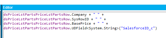

This debug is there to confirm that I have a new SFID to write and that SalesforceID_c isn’t populated in the dataset before doing the update by query.
After the update by query, the Write Debug 2 includes
to allow me to confirm that the dataset did get updated with the value.
And the entry in the Event log shows that SalesforceID_c is populated in the dataset before the Update BO is called.
