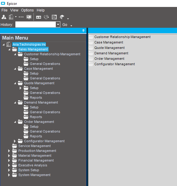

Stuck on Classic View
I have some users who are stuck in Classic View when it comes to the main sign in page even though they check the “Kenetic Homepage” checkbox on sign in.
What should I look for to get this fixed?

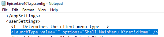

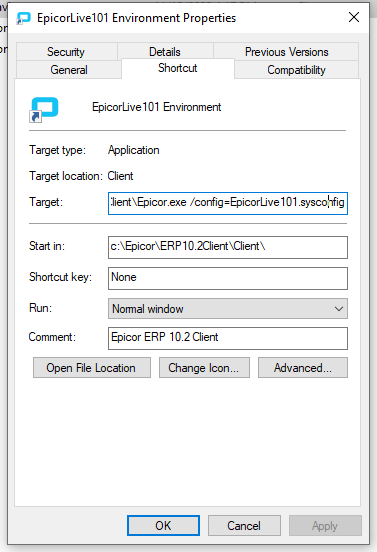

Is it set up that way in their sysconfig file on their client or the target path options on their shortcut on their somputer?
Nope it is not! That is why I am so confused.

Check in your sysconfig. From ‘back in the day’ when the home page was new the logic was designed to fail over silently.
<HomePageUrl value="" />
    <AppServerURL value="https://some.server.somewhere.net/ERPCurrentDev" />
If your HomePageURL value is empty it will default back without error or warning.
Patrick I was going to comment that but had no way to back that up haha! I could’ve swore I saw that it silently failed, but didn’t know how to tell Kyle to look for the failure or where to look for it!
Unfortunately my HomePageUrl value is not empty. I can resolve to this webpage from my browser as well.

Signed in using another users account, loaded correct homepage.
Signed in using my account, loaded the classic
Signed in using my account again, but unchecked the Kenetic homepage checkbox. Signed in classic.
Last time signed in using my account and rechecked Kenetic hompepage and now it works…lost for words.
