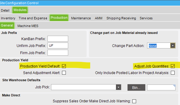

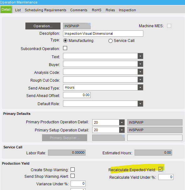

Couples settings that you will need to fine-tune prior:
Site setting:
Operation setting:
Also, that operation will need to be marked as “Completed”.
