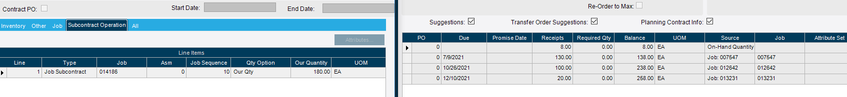

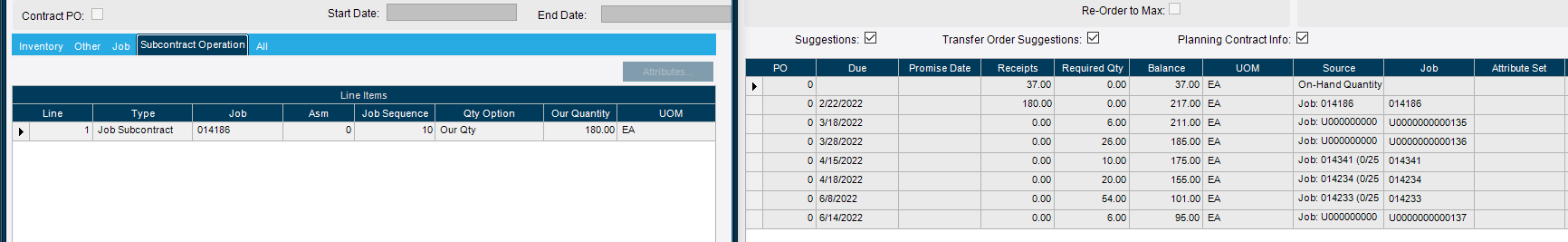

Is there a reason why Subcontract PO’s would not show up in time phase under the part being sent out or the return part?
Here’s the return part.
Here’s the part being sent out. Still nothing.
Subcontract PO’s are related to operations, not parts. So I don’t think it would show up in time phase.
Makes sense, I feel like I’ve seen it before display but could’ve been something else I’m remembering.
PO’s display in Time Phase for purchased parts. For subcontract parts, a manufacturing job is required in order to make the PO, so that job is what will display in Time Phase.
