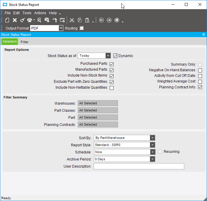

One of the issues we’re having is our Stock Status Report, which our controller would like to use as a subledger, is off by 53k. We asked Epicor about it and they said it wasn’t a subledger, so they couldn’t help us out.
We run this at the end of the month when no one is in the system and everything is static and still get this variance.
Any ideas what may be causing that?

What options is the Controller using when running the report? Including non-nettable? Non-Stockable?

This is how he runs it:

If there are non-nettable quantities, they won’t show up in the stock status run that way but may very well be on the GL. Also, non-Stock parts are not usually a part of inventory, so he may want to clear that one. Start there and then move on to the trickier items.
