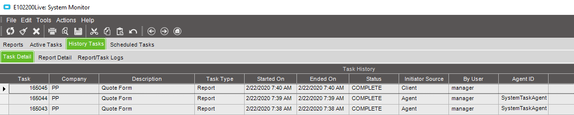

I have a Print Preview working successfully from a single button press in a Quote Entry customization. Only problem is that the System Monitor never goes to Priority Mode so the PDF takes up to 30 seconds to appear, while it takes 3 or 6 seconds when run from Action>Print Form>Print Preview.

This topic contains the same issue with a solution: BAQ Report slow - #5 by ckrusen
But, when I add these lines of code suggested in that topic,
using System.Reflection;
var mi = oTrans.GetType().BaseType.GetMethod("NotifySystemMonitor", BindingFlags.NonPublic | BindingFlags.Instance);
mi.Invoke(oTrans, null);
I get the error “Object reference not set to an instance of an object.”
