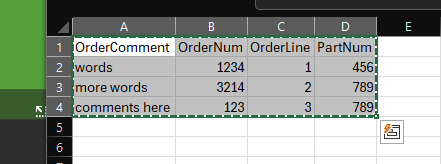

Also, in your table of info, if you copy paste from excel, it will make it a table. I can’t quite understand what fields are what.

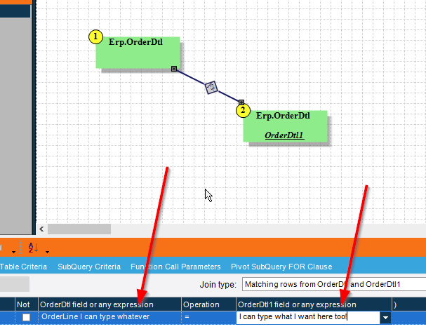

And maybe this is the tip you need. In the table relations, the drop down helps you fill in stuff, but it’s a free text field, so you can type in your expressions as needed here.

So I think you should be able to put what you need into the joins then by typing your stuff into the joins in the place I showed in the screen shot above then, no?

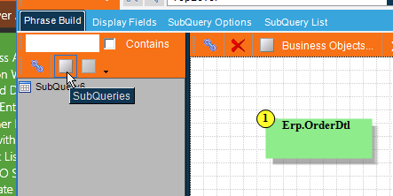

bring in the subqeury as a table on the top level, and do a join there. I don’t know why my button doesn’t actually have the icon, but that’s the button for that.

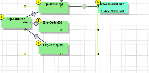

I’m like a lost ball in tall weeds here. Here is what I have
I’m only wanting the SubQuery(KnockDownCurb/OrderDtl) to return a PartNum for those rows whose OrderComment contains the calculated field value and whose LineDesc contains the value of Knock in it. That part I get, because is a constant value. What I don’t get is the part of whic I’m guessing is a SubQuery Criteria because it’s the only one of the three that I can even see the Calculated fields in.
Take your top level, and make it a subquery, then bring your KnockDownCurb sub, and your previous top level together and do the fancy join there.
