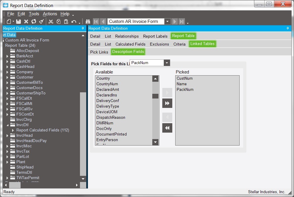

I’m trying to add a Tracking Number column from ShipHead.TrackingNumber to the ARForm by introducing a subreport into the ARForm Report, SSRS. I’ve setup the ShipHead to link with InvcDtl on RDD (Report Data Definition). In SQL terms it would be:
LEFT JOIN (This would be OUTPUT in RDD)
ShipHead ON InvcDtl.Company = ShipHead.Company AND InvcDtl.PackNum = ShipHead.PackNum AND InvcDtl,CustNum = ShipHead.CustNum

Below are some pics that show my settings and SSRS:
Table InvcDtl
Relationship InvcDtl to ShipHead
Subreport TrackingNumber’s Parameters
The Subreport Field on the ARForm Parameters
