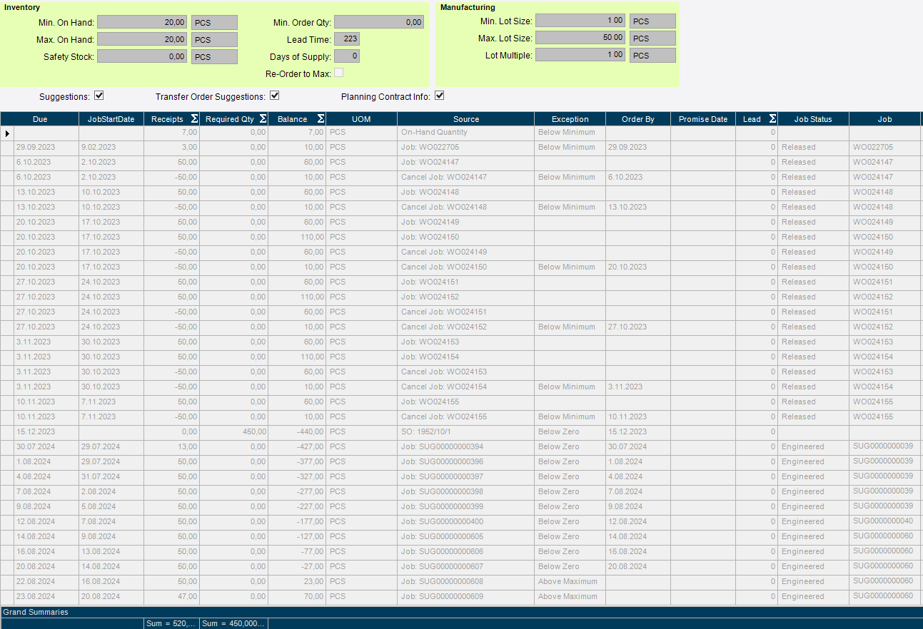

Suggestions planned after SO is fulfilled

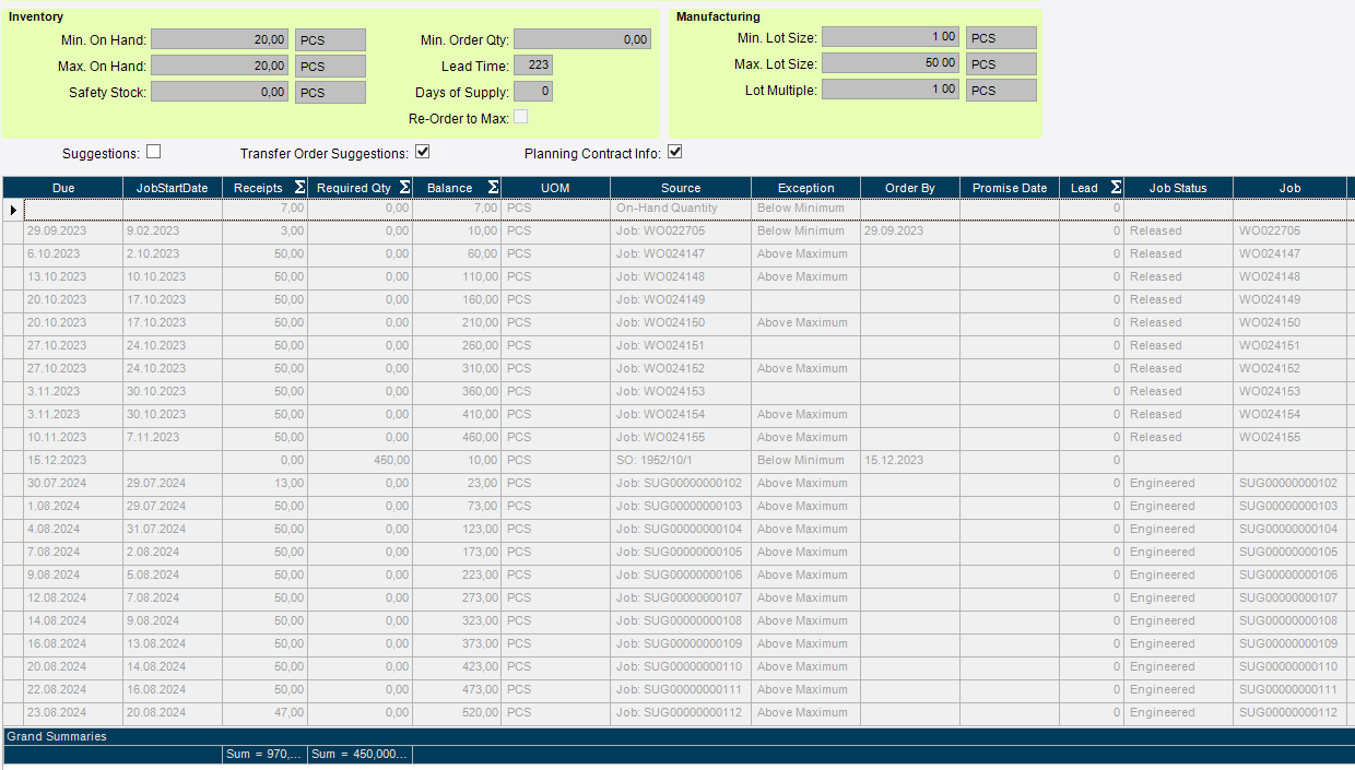

I have plowed in the WOs and POs and it does not make sense why scheduling plans additional suggestions against no demand months later. The POs for components are with due dates well within the WOs req dates also. The WOs and SUGs planned in time phase are like this:
I did find 3 components tho which have a strange scheduling log indicating that these are not available until 2024. Which does not make sense as PO due dates are in 2023. What would cause this?

Any bright ideas what to check?
For clarification when suggestions are included in the time phase then I can see that jobs should be cancelled. It does not make sense why this is suggested:
