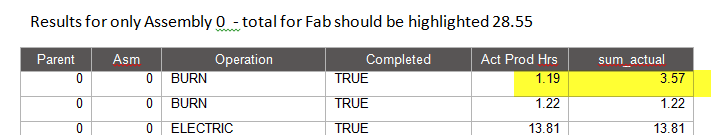

Are you saying that for your first example, the highlighted field on fab, 28.55 should be all of the fab ops? Looking at what you have in the list, all of the fab ops should be 119.27 (there are 6 ops called fab). Can you explain why the total should be 28.55?
Looking at the first line, we see the sum_actual is exactly 3 x the Act Prod Hrs. This leads me to believe that his dataset has 3 BURN lines with 1.19 hrs each.
Because he has GROUP BY on all displayed fields but sum_actual, separate lines are generated when the ActProdHrs differ.
If the ActProdHrs field is removed, and a count_actual added (formula being count(JobOper_ActProdHours) ), he’d see:

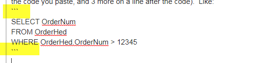

Copy the Query Phrase from the BAQ and paste it here.
Put 3 gave characters (the backwards single quote next to the 1 key) on a line above the code you paste, and 3 more on a line after the code). Like (ignore the actual code between the opening 3 graves and closing 3 graves, it’s just an example) :
That will make it look like the following when you post it.

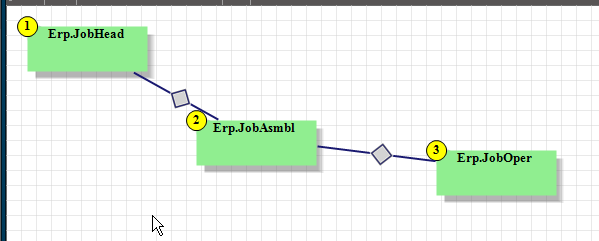

Do you have the Job Header joined directly to the Job Operation table? (I suck at reading SQL)
Job Head, doesn’t have enough info to join directly to JobOper, (Usually). You’re going to get some weird stuff if you don’t do it this way.

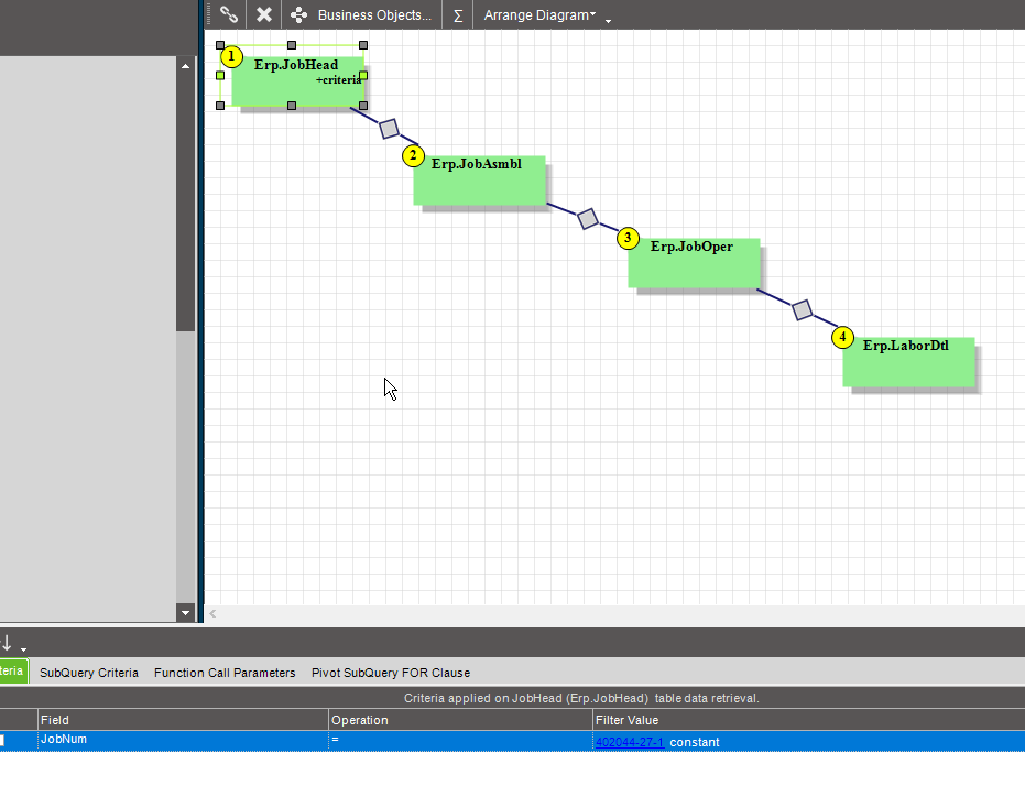

You should have Job head at table 1 joined to JobAsmbl joined to JobOper. Like shown below.
Here are your tables, with one criteria. The joins should come in automatically if you do it this way.
Here are your display fields with group by
and here is your calculated field.
I did this really quick so I might have missed something, but it should work.
I didn’t have Job Head in there! Thank you so much!!! It worked!!!
