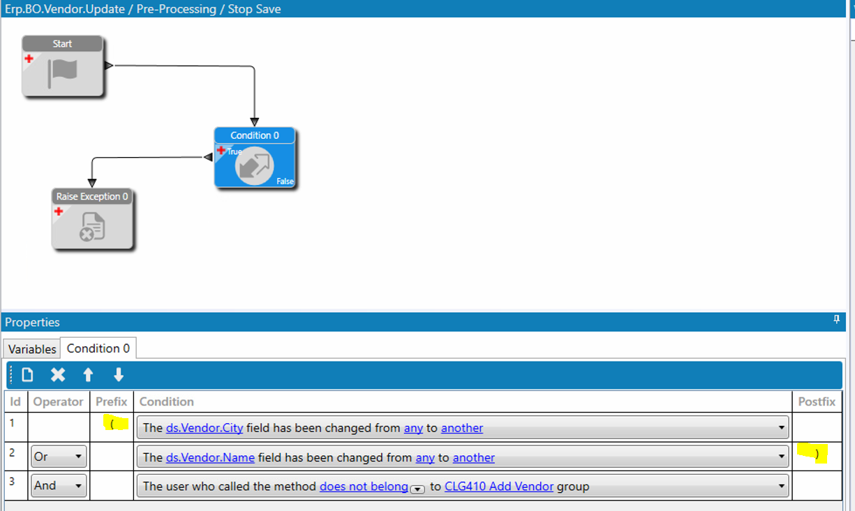

For the four fields it would simpler to make a condition that any of the fields have changed with ors wrapped in parens then a user does not belong to the full access group and throw an exception.

Thanks Greg! I like the sound of this, but have to confess that I’ve not created any conditions in the past. Can you point me to a quick primer on this topic?
This should do it. Just add more ors
Edit don’t miss the closing paren
Thanks again, Greg. I’ll work with this and test it out.
