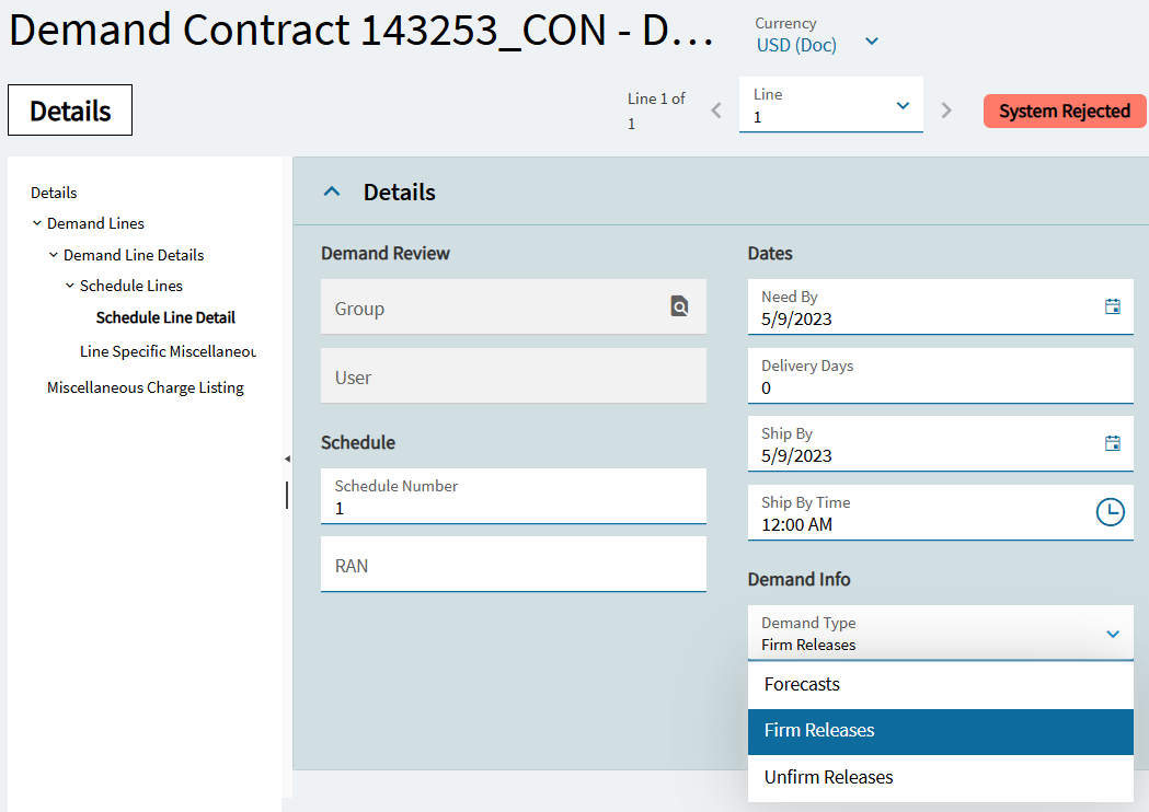

If Demand Management’s an option…demand contract/entry? There’s an option for forecast/unfirm/firm.
Screencap...
