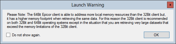

Hello,
How can i suppress the warning message for all users that opens when one launches the 64-bit version of the client?
Hello,
Hi Jeff -
This one had been bugging me for a while too, but I did eventually find a solution. When you acknowledge the message and say “Do not show again”, an XML file called “WarnedVersions.xml” is created in %userprofile%\Documents\Epicor. So, if you batch deploy a copy of that file to each user’s Documents directory, the error will be effectively suppressed.
