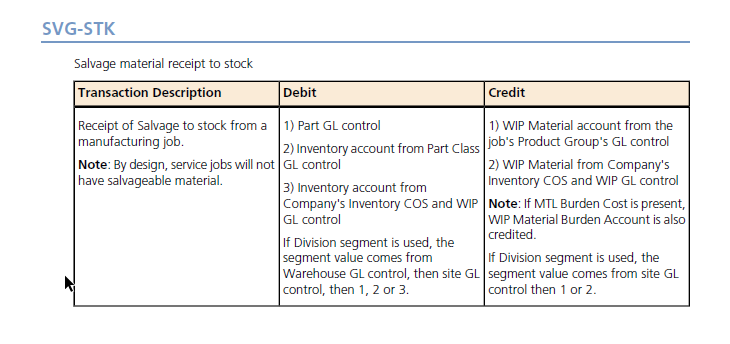

This might be a case of wanting to eat the cake and hitting a specific GL Account too, but here goes:
CFO wants to have SVG-STK transactions hit a dedicated GL Account. This GL Account is not the same one as the Part GL or the one from the CO’s COS and WIP GL Default Inventory account. Is there a way where I can specify this account to be used for all SVG-STK transactions? It would have been nice to have some functionality like Reason Codes do when making adjustments…
I am not comfortable enough to hardcode something from scratch in the posting rules, but maybe someone has done something like this and doesn’t mind sharing?

It isn’t feasible to create new parts for each salvaged part, so I tried alternate ways and ended up with changing the posting rule to hardcode the desired account number instead of the Standard Rule’s “Inventory Account” for the SVG-STK transaction.
Testing shows we get the desired results from the SVG-STK posting, although we still have to decide how to re-issue the salvaged parts to a different job and hit the “Salvage Inventory” account instead of the default Part Class GL. Only Part trumps that, but we don’t want to have to add Part GL’s on each of the salvaged parts.
