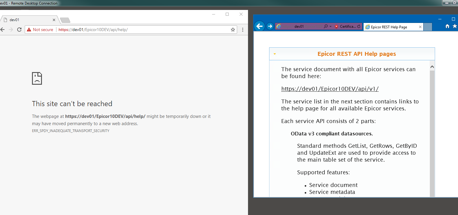

So here’s a weird thing, same address and same server with two different browsers, and one can see the help page while the other does not.
It doesn’t like your certificate… by the looks of it.
Hmm, dumb question but what should I do about that?
So your error in chrome is SPDY INNADEQUATE TRANSPORT SECURITY… Looks like your SSL on your cerver, particularly this certificate is using an old / black listed Cipher…
Who setup your server / ssl cert?

ok… that’s odd… Server 2016 shouldn’t let you use an old Cipher Like that by default unless you specifically requested it.

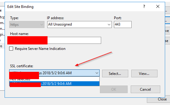

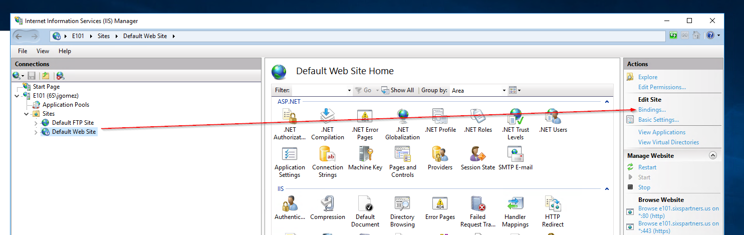

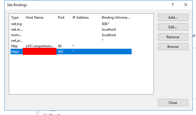

Can you log into the server and take a screen shot of your SSL certificate setup within IIS?
Expand Sites, Default Website and Click on Bindings on the Right Side

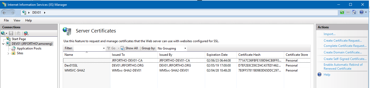

The DEV01 SSL is assigned in my HTTPS binding for the Default Web Site

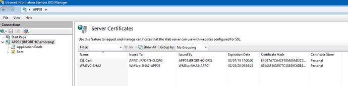

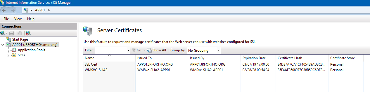

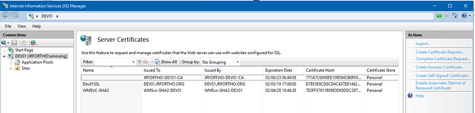

I recreated a new SSL and removed my application sever. I then re-created the application server through the admin console and assigned the new SSL to it and then registered the existing application. This is all well and fine and I’m able to get into the application with no trouble.

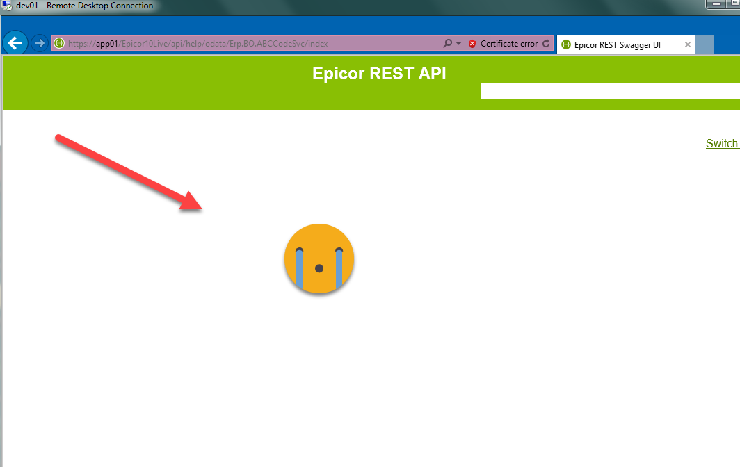

When I navigate to the site in IE, I get this page:
In Chrome, it’s still looking at the old SSL and I will mess with it later, but IE is concerning
