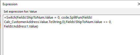

I want to now add switch statements the existing invoice address fields to say if ShiptoNum = blank then display, if not blank then display new field. However im getting a too many functions error:

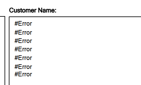

I have got it working now when ShiptoNum has a value- however when it does not have a value and so we want it to use the standard logic the report runs and shows error
I think .value on a NULL field will throw an error.
When ShipToNum doesn’t have a value, do you mean that it is passed as 0 or is it null?
If ShipToNum always has at least some placeholder value (like 0), which may be the case looking at your switch statement, the problem probably lies in your SplitFun code.
If it’s null, I would try using just an iif statement with an isnothing as the condition:
=iif(isnothing(Fields!ShipToNum.Value),TRUE STUFF, FALSE STUFF)

Your error screenshot says it’s the Visibility.Hidden expression. This check has to return TRUE or FALSE. You’re returning an address line into an expression that isn’t expecting it.
