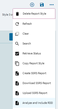

@ckrusen @bderuvo This is what we are talking about:
Following the official Epicor learning module: “Complete SQL Server Reporting Services Self-Paced Course” or “Create Report Style” brought me here because step #7 is:
Verify that the cursor is still on the newly-created style. Navigate to Styles > Style Detail sheet, click Sync Dataset.
I couldn’t find that button so I would like to thank you all for being more up to date than the official training.
However, that leaves me being a noob with no direction. I just added a couple of fields to my dataset. I need to get them in to my report.
What do?
There appears to be some a function that sounds similar but it doesn’t add new fields. It’s called “Analyze and Include RDD”. This function claims that everything is fine when it is not. So I’m not sure what it is supposed to do.
