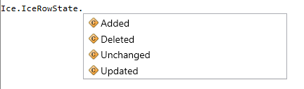

Is there any enum in the system that can be used in BPM for SysTask.TaskStatus? Something like for rowmod

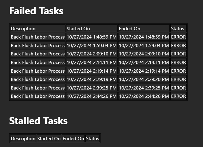

What I’ve done is create a scheduled function and pull the data from the tables. I then take those tables and pretty up the email with html formatting. Example:
