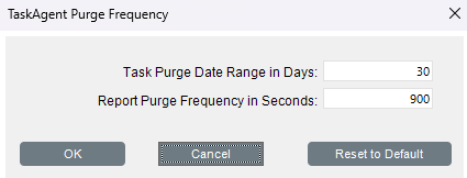

It is supposed to be automatic. Go into System Agent and click on Actions for your Agent:
Try changing it to 45 days and then restarting the Task Agent service. If that doesn’t work, I would submit a ticket.
