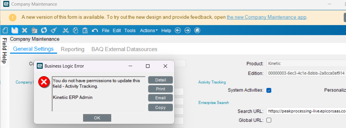

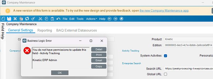

And say what now? I am the Security Manager. Have been for 5 years now.
