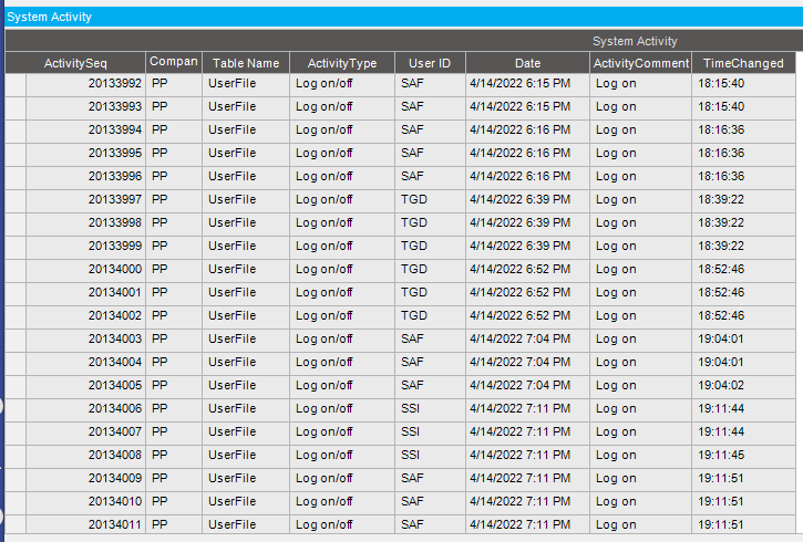

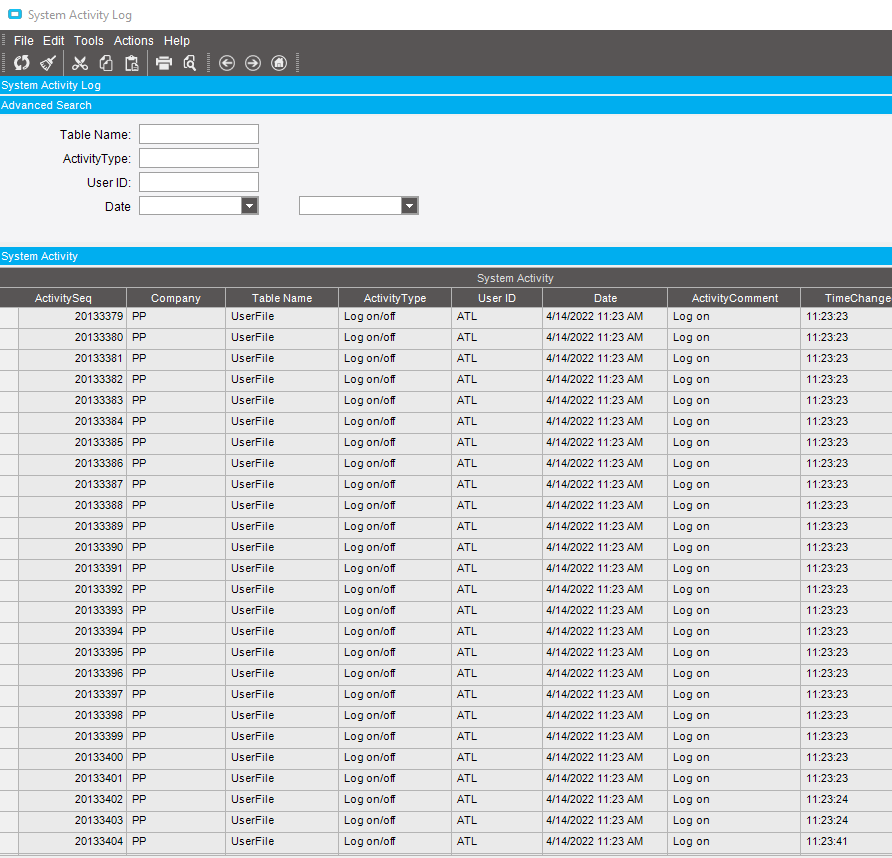

But, I see that certain users generate dozens and dozens of “Log in” records in this ice.SysActivityLog table throughout the day. For example, I opened Epicor this morning, opened System Activity Log, and saw 85 Log in" messages created in a few seconds like this:

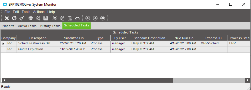

Does the System Agent show recurring tasks?

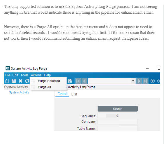

I do NOT have track system activity checked and STILL get tons of these rows. Support insists logons are tracked whether you check that box or not. So I don’t understand the point of the checkbox. I am unable to purge ours because there are too many records (55 million+). Support insists my only option is to use the system activity purge program which of course will not work on that volume of data. Because I can’t prove that the records are currently causing any specific issue support is unwilling to offer any other solution.
Mark,
Do you mean scheduled tasks in System Monitor? Only 2
And System Monitor mostly shows no Active Tasks unless someone prints a report.
The Ice.SysTask table currently has 5 rows, all reports with COMPLETED status.

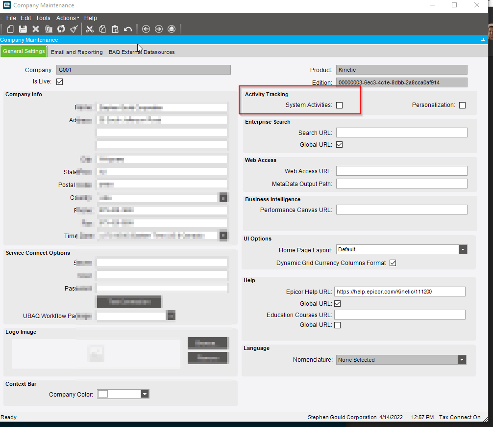

Can you turn System Activity Logging off? (Company Maintenance)
Company Maintenance-General Settings Fields
System Activities
Select this check box to track the system activities occurred within the application such as changes to the Company record, logon failures, user logins and logouts.
These activities can then be reviewed within an activity log. You display this information by launching the System Activity Log Tracker; access this tracker from the Main Menu by opening the System Management > Security folder.
Yes, I can turn off System Activity Logging, and unlike @aosemwengie1, it does in fact stop all logging to the table.

I know, I want support to tell me its ok to do that. So far they are insisting its not acceptable and I have to use the purge program.
They never will, updating Epicor via SQL is directly against their support agreement.
Yup! I was reluctant too. Have them reference my case… Or worst case, insist on uploading your database, and let them see first hand that the purge app will crash eventually with that many records. Escalate the case, and you should get someone more senior that has done this fix before.

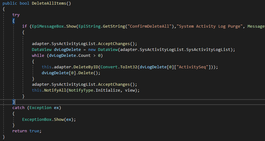

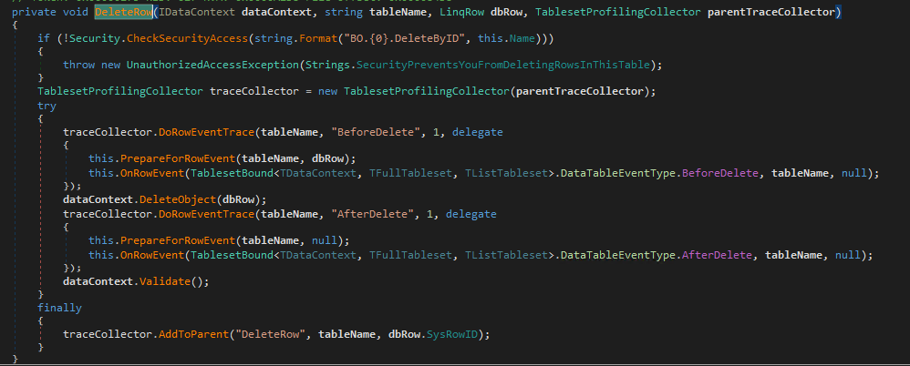

For what its worth all that program does is call DeleteByID on each item one at a time
Which then uses the back end Service

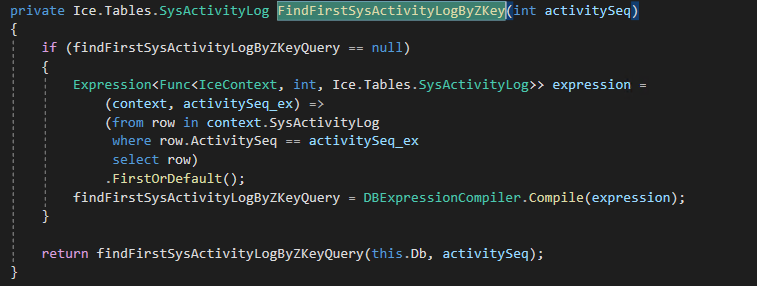

Which literally finds the row in the table SysActivityLog by AcitivitySeq

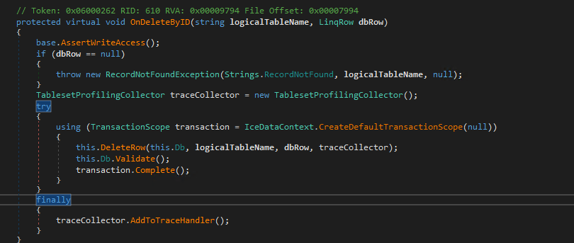

Then calls the “Base” OnDeleteByID which takes the current row and deletes it form the given table.
Which just creates a transaction and calls DeleteRow
Which uses the Db Context and calls DeleteObject (passing in the current row)
Which is a remarkably long way to do TRUNCATE TABLE . As far as I can tell Epicor doesn’t do any other dependency checking or has any FK Constraints on that table.

User ATL is my own account. I have system security privileges, but otherwise I’m just a user. All integration system processes use a “manager” user account. It seems some user accounts generate lots of these login messages and others do not.
There are only those 85 login message in a row when I start up the Epicor client. Once loaded, the messages stop until I open a new screen or enter data in an existing screen. Then, there are usually batches of 3 log in messages in a row anytime any user enters data into a screen. Like this:
