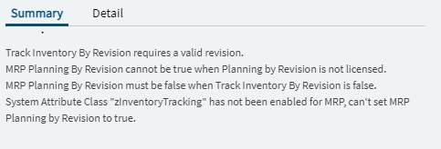

System Attribute Class "zinventoryTracking"
Does anyone know where this setting is? I ended up with an error code when using UOM conversion utility and trying to check both the Track Inventory by Revision and MRP Planning by Revision
First, you need the license.
Then parts with revisions.
Then, for inventory tracking for the a existing part you need to clear the warehouse via inventory adjustment. Then, add tick box the tracking inventory and adjust the quantity back. Can be done with DMT with issue and return material
The last item I ran into myself just now and was looking for answers,
