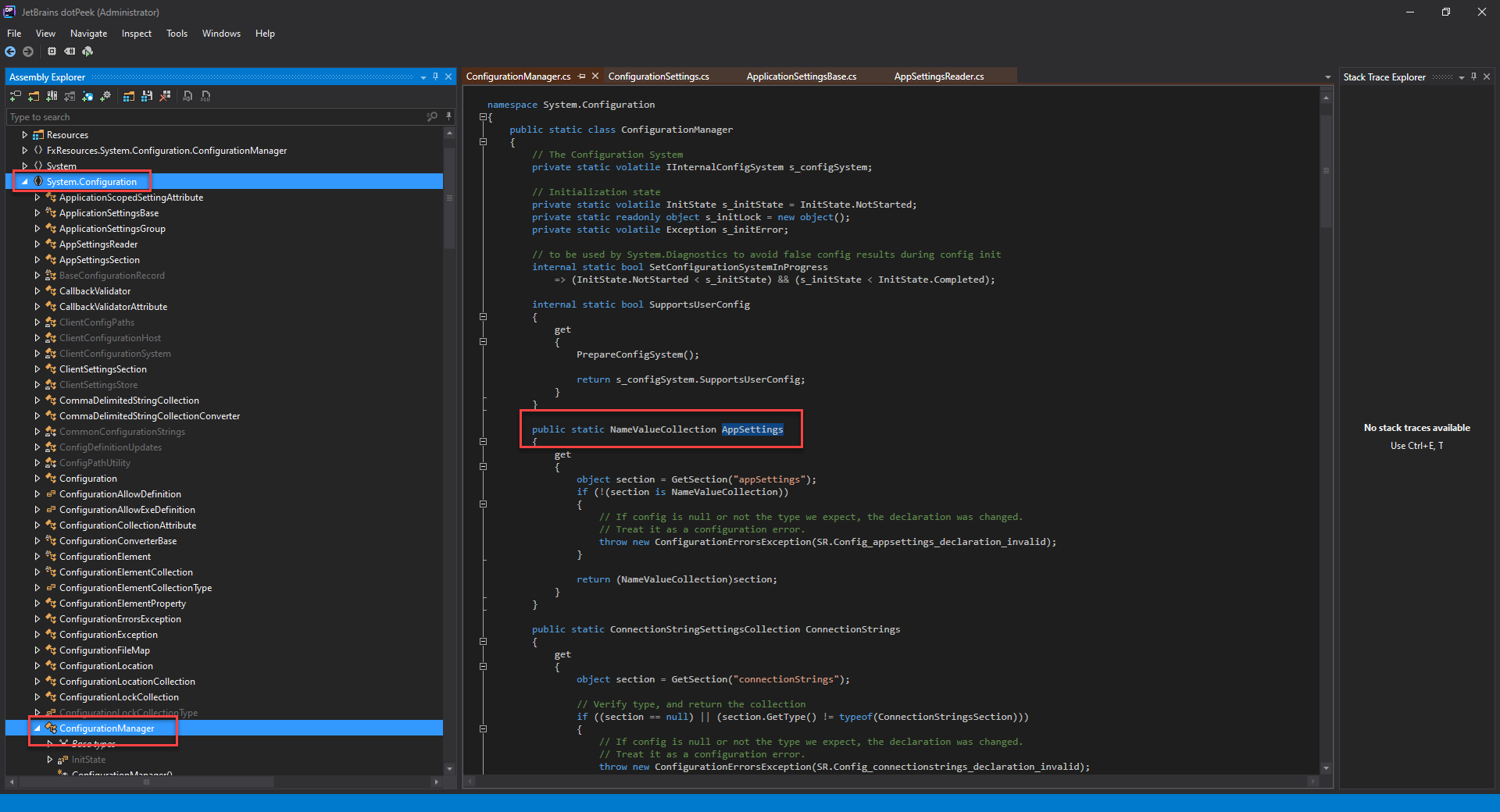

Microsoft has replaced System.Configuration class with IConfiguration interface in .Net Core, or requires you to include it yourself via nuget.
i did not try .NET 6 server with linqpad, but just from looking on the screen I can tell, that you will have to rewrite this.
easy part - settings are now in host.config, not web.config
.NET (Core) does not use AppDomain at all.
Also Configuration manager was changed beween .NET Framework and .NET Core.
So probably it would be easier to start from scratch - create new .NET project and try to use ERP DataModel first, then add additional code you need.
(also, just in case, it should be linqp…

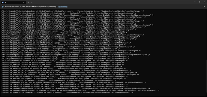

Did you ever get a solution to this? Seems like we were having the exact same error due to the exact same code in the EI File
