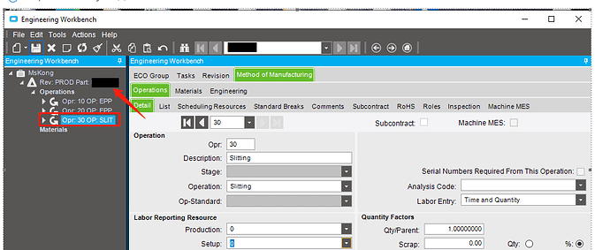

System hangs when add and save operation in Engineering workbench. And i have to restart Epicor all over again. Can anyone please advise what should i check?
