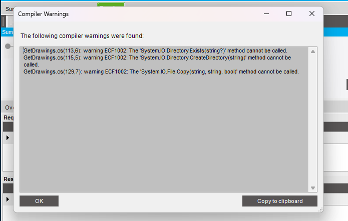

I have a function that checks to see if folders are available and since i upgraded from 2022.2 to 2023.2.5 i am getting this error so im not sure what i can do to fix it.
The ‘System.IO.Directory.Exists(string?)’ method cannot be called.
What’s the whole context of the function and do you get the error at compile time or execution time?
The context of the function is get all drawings that are attached to a part or PO and uses a BAQ see code below. This error i am getting when i try saving it.

Interesting so first its just a warning and I got it too but I wonder if Epicor is trying to sanitize some of the code and this is a madeup message by them.
A quick google doesn’t show this as a real compiler message and further more when I take the generated code and compile it myself it doesn’t give me that warnig.
@Olga or @pferrington or @Rich is this a new “feature”?
Confirmed that this is a compiler warning and not an error.

I’ve just encountered this ‘warning’ on a BPM that creates an XML file for a shipment. I inherited this BPM and am considering the most efficient way to re-code the BPM without System.IO. Currently, StreamWriter is used with MANY WriteLines. My first thought is to concatenate all the WriteLine values into a fileContent string and then call the FileTransferSvcContract. Is there another approach to this that I should consider?
Yes. I think you’re on the right track.
System.Text.StringBuilder is a very performance-efficient way to build a large string. Then, you can call a single write to create the file.
